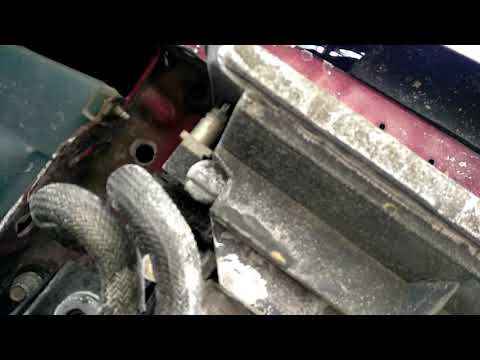

    The video makes it sound louder than it really is. Noise settles down but never completely goes away. In real life, when the car is warm, you barely hear it. But it is quite loud when cold. It's almost like the old lifter noise you'd get with a sluggish lifter, but this AJ motor is over head cam... so I wouldnt think the actuators would have that much play. But what do I know, thats why there's TBN! :)
