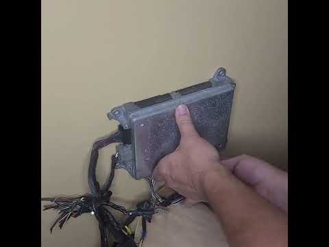

              This is a b.... To remove the FEM out of its position. I have the 3 nuts and one bolt out and the the bottom connectors off BUT the FEM will not maneuver out of its position. The long body bolts will not let me leverage it or wiggle it out. FRUSTRATING...
              My only option right now I think is to cut one of the body bolts off and then maybe that can give me a little more wiggle room down there to remove it.

                Sometimes a junction block on the adjacent floorboard is in the way, remove the 2 nuts and move it out of the way ( no need to disconnect the wires), and I'm sure you already have the battery disconnected. It needs to come straight out, wiggling will jam it in place. Try a plastic pry tool on the back

                  Thanks, that did the trick. Once I removed the adjacent junction box I was able to remove the FEM straight back. Now all I have to do is figure out how to disconnect the tan plug from the side of the FEM. I see from pictures that only the top part comes off but at moment that is giving me HELL also. I normally am very good at these things, but this operation is giving me pains. Great to share knowledge on this forum........

                      The release for the gray plug is on the side (in the video above)
